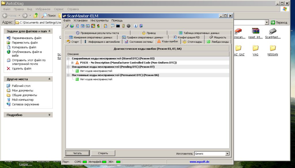

Всем доброе время суток!
Обшарил уже весь инет, на тиче то же не нашел, что за ошибка вылезла Р1631. Если можно хотя бы расшифровка. Авто Kia Sorento 3.5 2004.
Прошу помочь.

avtoteh_dnepr писал(а):что за ошибка вылезла Р1631
P1631 No ID from ECU
ECM(Engine Control Module) send the various information to TCM via CAN communication line. Without CAN communication, an independent pin and wiring is needed to receive a sensor information from a ECM. The more information to be communicated, the more wirings is required. In case of CAN communication type, all the information need to be communicated among control modules such as TCM, ECM and TCCM (Transfer Case Control module) use CAN lines. Engine coolant tempeature information is used for lock-up control. If the TCM detects the no message on CAN BUS line, the DTC will be set.
CAN Communication Circuit Inspection
1. With ignition off, disconnect TCM connector(H-01).
2. Measure CAN high circuit resistance between ECM(C17/B-01)and TCM(A24/H-01)
3. Measure CAN Low circuit resistance between ECM(C18/B-01) and TCM(A16/H01)
A. Test Condition : Ignition "OFF" & Engine "OFF"
B. Specification : Approx. 0Ω
4. Is resistance display near the specified value?
YES
1) Go to Step"2.Terminal and Connector Inspection".
NO
1) Check for an open or short to ground/battery in the CAN circuit between the TCM and ECM
2) Repair as necessary and go to "Verification vehicle Repair" procedure among the tree on the left-hand side of the window.
1. Many malfunctions in the electrical system may caused from poor harness and terminals. These faults can be caused by interference from other electrical systems and mechanical or chemical damage.
2. Check the following conditions:
(1) Check for damaged harness and terminals: contact resistance, oxidation, bent or broken terminals.
(2) Check for poor connection between ECM and component: backed out terminal, improper mating, broken locks and poor terminal to wire connection
Есть только англоязычное описание ошибки процедуры ремонта-проверки.
