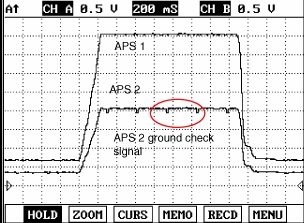

Сообщение Evgeni39 » 31 окт 2018, 21:09
Алексей, это нормально.
ЭБУ двигателя проверяет исправность датчика APS2, вот фотка осциллограммы из GDS и объяснение по ошибке P2299:
APS 2 Ground checking signal is for ECM to monitor APS 2. This signal drops APS 2 output voltage to below 200.39mV per 200msec. If APS 2 output voltage does not drop to below 200.39mV, ECM sets DTC as recognizing ground circuit error of APS 2.
The waveform below 200.39mV is not detectable in Ground checking signal waveform of APS 2 signal. Instead, the waveform which drops a little is detected. If APS 2 data of "SERVICE DATA" on the Scantool varies from 350mV to 0mV periodically, it means it works well.
